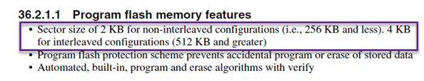

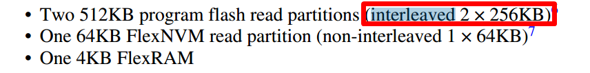

hello,
how to  understand the following description?
thanks for your answer!

It is explained in the RM, Section 36.2.3 Glossary:
The FTFC command parameters and the sector size depends on the path width.
