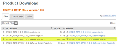

there's always Release Note file for each SW package like this:
And this file contains detailed description how to install such package and what needs to be installed before that. See please section "6.4 Installation of TCP/IP Stack package over RTD" in this file. Have you followed all the steps?
