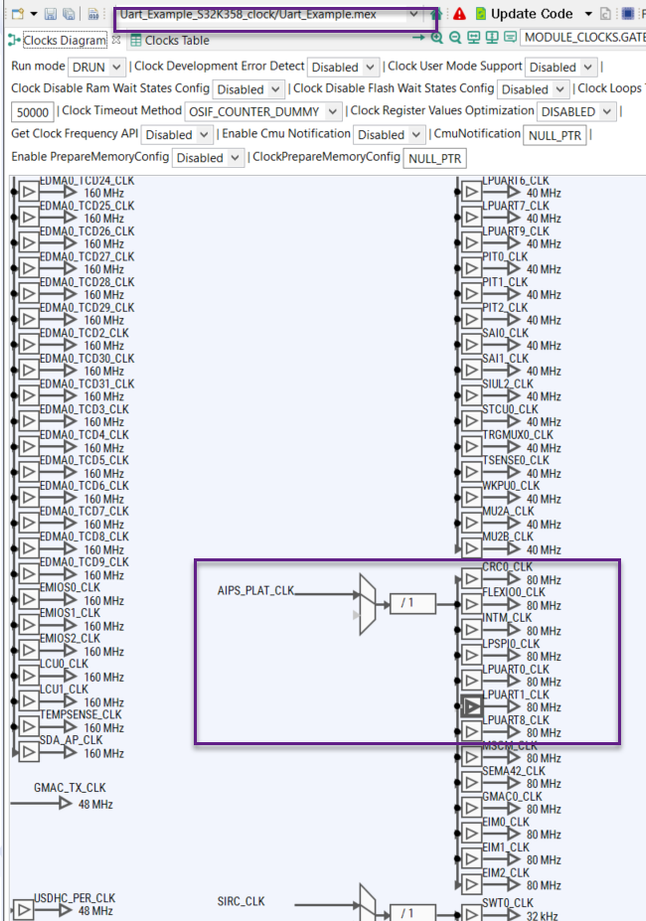

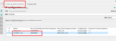

In S32k358, how can I use  already defined clk ?
Thanks!

Hello @jimmy623,
I see, it is a bug in RTD 3.0.0, it has been fixed in RTD 4.0.0

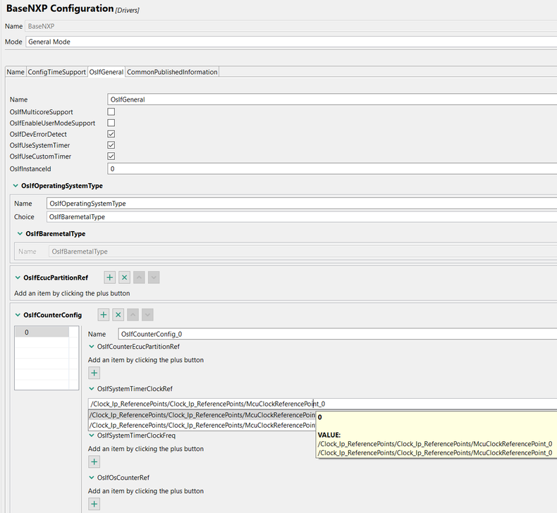

danielmartynek
Hello @jimmy623,
The references can be used by other RTD drivers.
Such as BaseNXP Osif Config, see below.
There is no list of drivers dependent on the clock reference points.

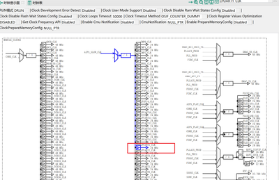

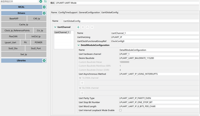

jimmy623

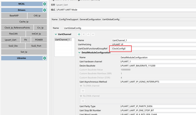

How can i use to LPUART driver ?
default Baud rate is 40M ,which mismatch to Reference design.
Thanks!
4,761 Views
danielmartynek
Hello @jimmy623,
The LPUART modules are clocked either by AIPS_PLAT_CLK or AIPS_SLOW_CLK depending on the number of the instance, this cannot be changed. Refer to the RM.

jimmy623
This is a Bug?
4,757 Views

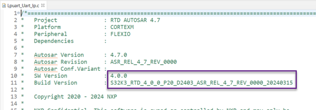

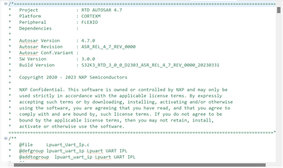

danielmartynek
Which RTD version is it?
Thank you.
4,755 Views
jimmy623
RTD AUTOSAR 4.7
4,753 Views
danielmartynek
That is the Autosar version, I mean RTD version.
For example, in this version, it is correct:
4,707 Views
jimmy623
I will check RTD 4.0 later
4,704 Views
danielmartynek
Hello @jimmy623,
