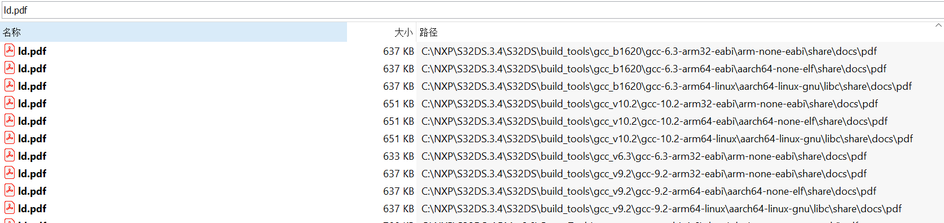

how can i find linker reference guide for COMPLIER:S32DS 3.4

It's usually in the help document ,but i can not find it

Hi@续开轩
those documents can be found in S32 DS installation folder;
for example.
