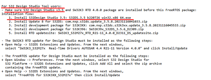

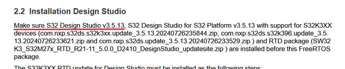

reading the release notes it states:
SW32K3 FreeRTOS 10.6.0 version 4.0.0
reading also SW32K3XX FreeRTOS version 5.0.0 CD
If you do not follow the installation flow, then unexpected issues can occur.
