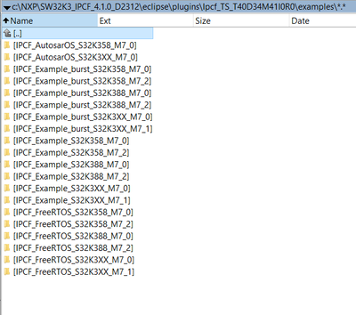

Good morning, i'm trying to study the IPCF module regarding the NXP s32k324 micro.
I started from the ref design example: https://www.nxp.com/document/guide/getting-started-with-the-mctptx1ak324-evaluation-board:GS-MCTPTX1...   which contains the IPCF+DMA management.
I wanted to ask if there was any other project that contained an IPCF implementation (maybe both managed and unmanaged) in order to study the various aspects. I'm looking for IPCF examples as case studies also considering that the documentation regarding the IPCF seems quite limited to me(i only found a product brief).
thank you in advance for any information/help.

Example codes you may find within installation directory as screenshot below:
