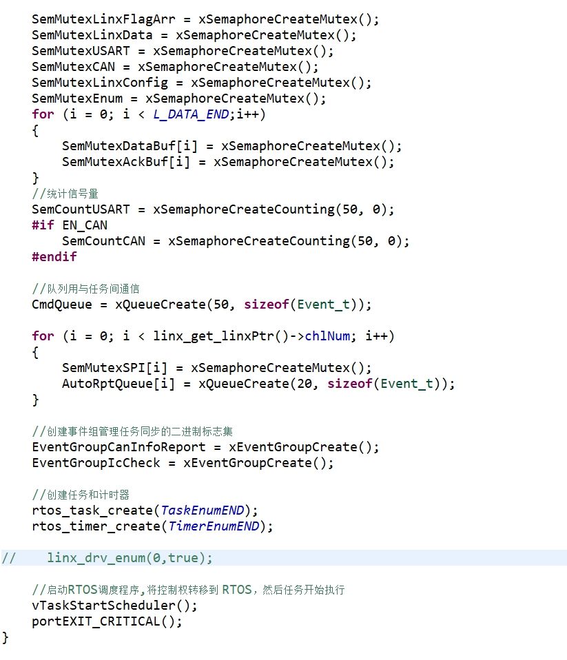

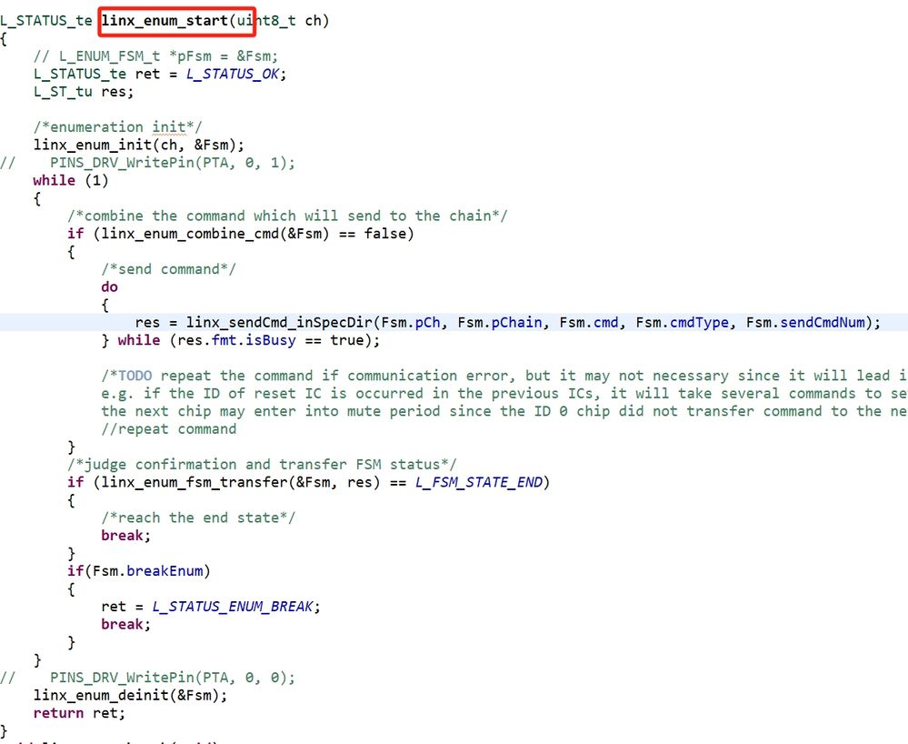

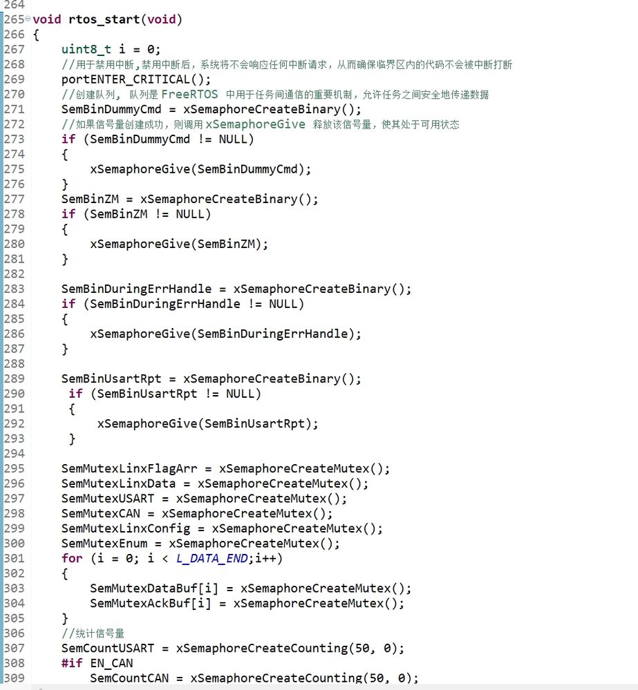

Hi @muggle,
Could you please share the device, IDE and SDK version you are using?
Looking at the images you've shared, it seems you are using an S32K1xx SDK + FreeRTOS. Please share if this is an example, or if this is a custom project.
Also, please correct me if I misunderstood your question, are you asking where to put the "linx_enum_start" function?
Julián
