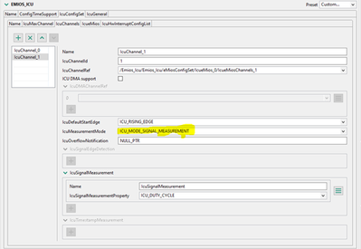

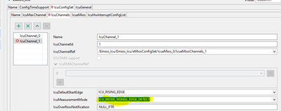

I am trying to configure the SAIC to trigger on the rising edge and measure the PWM signal upon triggering. However, I am facing an issue:
  • When I configure the SAIC in 'Measurement' mode, it triggers continuously rather than only on the rising edge.
  • When I configure it in 'Edge Trigger' mode, I cannot measure the PWM signal.
The desired functionality is to calculate the PWM using 6 SAIC eMIOS channels only when PWM is given. How can I resolve this issue?
GaneshBhagwat_0-1736155083584.pngGaneshBhagwat_0-1736155083584.pngGaneshBhagwat_1-1736155115316.pngGaneshBhagwat_1-1736155115316.png
If I use the above settings with the specified interrupt, the interrupt is triggered regardless of the presence of a rising edge or pulse on the pin. Even when there is no rising edge, it still enters the interrupt function.
If I use this mode then ‘Emios_Icu_Ip_GetDutyCycleValues’ function  does not return a value its always ‘0’
Could you please help me resolve this and suggest the best approach to achieve the desired functionality?
