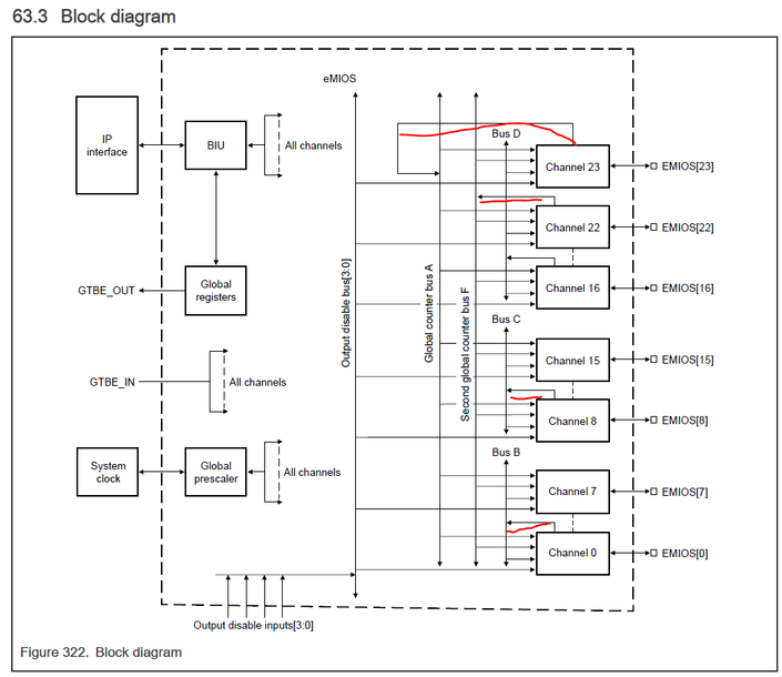

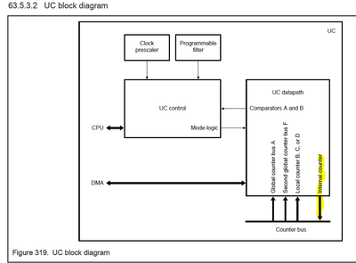

Does the internal counter have an effect outside of its own channel? For example, if I have two channels (one input and one output) running on their own internal timebase will they interfere with each other? In this diagram it seems like the internal counter feeds back to the Counter bus.
Thanks!
Vusal

Hi@vusal
Some channels have internal counters, which can be output as Couner_bus_A, Couner_bus_B, Couner_bus_C, Couner_bus_D, Couner_bus_F.

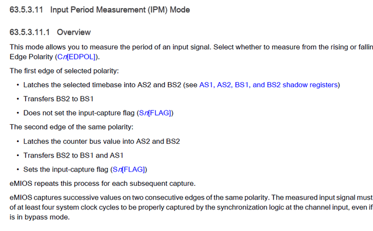

Any thoughts on when reading A and B in the IPM mode, FLAG bit doesn't get set and instead I have the OVFL bit?

Hi@vusal
please read the S32K3'RM ,the chapter 63.5.3.11 Input Period Measurement (IPM) Mode for detail.
