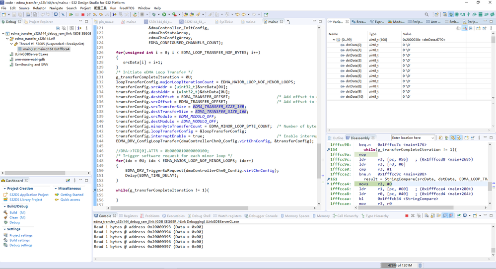

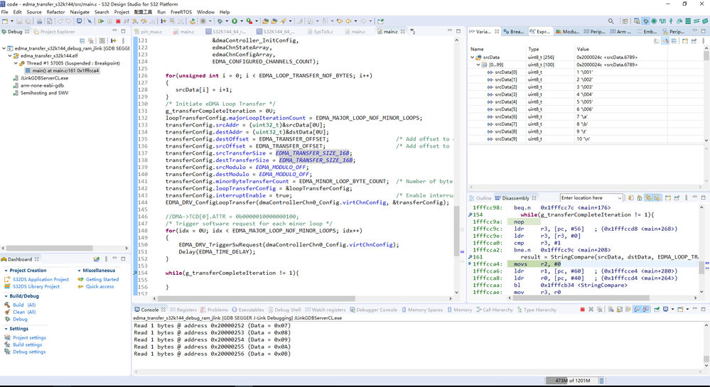

when I create a new project from example edma_transfer_s32k144, I wang to transfer 16B , so I  change
transferConfig.srcTransferSize = EDMA_TRANSFER_SIZE_4B;
transferConfig.destTransferSize = EDMA_TRANSFER_SIZE_4B;
to
transferConfig.srcTransferSize = EDMA_TRANSFER_SIZE_16B;
transferConfig.destTransferSize = EDMA_TRANSFER_SIZE_16B;
But the dstData displays all zero not the srcData content
could you help it? thank you

Hi, have you changed MINOR_LOOP_BYTE_COUNT as well?

I only change the
to
, others has no change.

And that's exactly the mistake if I understand what you want to do.
