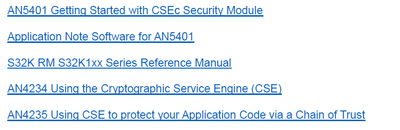

Here are a few documents for reference, you can try to find them on the official website.

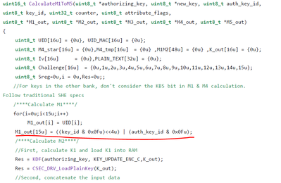

     This is a DEMO to calculate the value of M, you can refer to it.
Senlent_0-1628649420978.pngSenlent_0-1628649420978.pngSenlent_1-1628649467357.pngSenlent_1-1628649467357.png

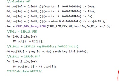

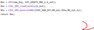

using the code in the project, we will generate values for M1[4] and M2[8] and M3[4] based on the new key value and the counter and the key slot and authorizing key.
NOW MY QUESTION IS VERY SIMPLE;
the COUNTER VALUE and  THE NEW KEY VALUE  which was used to generate M1,M2,M3, are in any way reflected in the values for M1,M2,M3 ? Are they in a decrypted form embedded in M1,M2,M3.

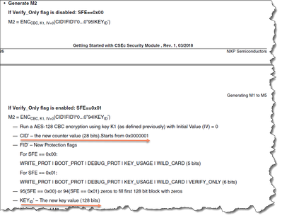

Both ‘COUNTER VALUE’ and ‘NEW KEY VAULE’ are used to generate M2.
CID : (COUNTER VALUE) Key Counter ,related to user key.
KEY(ID):NEW KEY VALUE.
The counter value related to user key.
Is this the answer you are looking for?
Each time the KEY content is updated, the MCU will automatically update the CID value. Therefore, when calculating the M value offline, you need to record the number of times the KEY has been modified.
