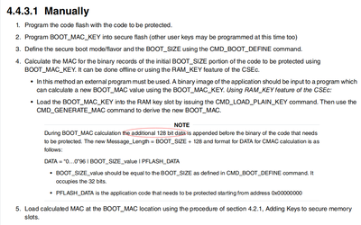

I caculate MAC in CSEc mocule by CSEC_DRV_GenerateMACAddrMode function as follows,
but it compare with the value that caculated by mbedtls Algorithm library as follows,
the result is diffent, check failed.
we can caculate the mac by other methods? and, we need add 128 bits datas? like this, as follow
and checkking it caculated by CSEC_DRV_GenerateMACAddrMode.

lyz
the problem had been solved, the result is same as.
thanks!

lyz
使用这两个接口计算,
一个是4字节4字节取的数据,一个是一字节一字节取的数据。保证字节序一致,两个算出来的MAC值是一样的
