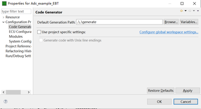

bowen_gu
Hi Hung,
I didn't change any configuration except project_parameters.mk.
the code default generated path  as below:
Maybe, I need to modify this path to point the ADC example project  and build directly without any change.

hungnguyenphi
Hi @bowen_gu
Could you please check if you have generated configuration for the project.
Please also use the newest RTD version RTM 1.0.0 instead.
