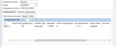

I make a project in S32DS, but I can't change UART Baudrate. If I change in the table, it will say error

what S32DS and SDK version do you use? I tried lpuart_echo_s32k144 demo example in S32DS2.2 and SDK 3.0.3 and the baudrate can be changed. Just modify Baudrate item, generate PE code and build project. No error is seen and project is built, elf generated.

I am using S32DS for arm v2.2 and SDK 3.0. I tried again, and 3000000 is not OK. but others are OK. why 3000000 is not OK, how can I solve it?

the error displayed is below
So the LPUART clock selected in the clock component is low and 3Mbit cannot be calculated for it.
By default SIRC is selected (8MHz), I think. Go to clock_manager component and select different clock source with higher frequency for your LPUART module.

Got it, thank you!
