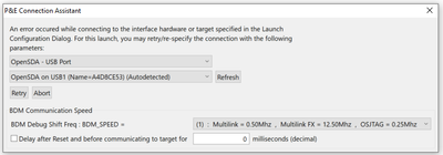

I am using S32K148 Evaluation board and S32 Design Studio IDE.
When trying to download firmware, the following windows always appears:

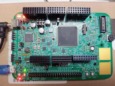

I am able to see the S32K148EVB in my PC when connect the board.
The LED D11 reset indicator is on all the time whenever connect the board.
If board has locked, what steps to unlock the board? Can I try it?

Hi @Shaba
You could try reading the MDM_AP registers first, as discussed in these community posts:
