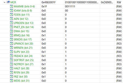

AparnaSridharan
Hi @PetrS ,
I tried to configure Flex CAN with your code. But I cannot receive message. When I tried to transmit message from vehicle SPY it shows Tx message is aborted for all id. When i tried to pass message with id 201 also the buffer is not filled with mesage. but i can see id alone.
For your reference I have attached MCR register.
Could please tell what I have missed?
4,763 次查看
PetrS
is FlexCAN running, or your code is running? From your picture FlexCAN is in freeze mode, so do not communicate. Try to clear FRZ bit too so module will run when debugger is stopped.
Do you have RXIMR really set?
Do you see any kind of error? check ECR/ESR1 registers.
BR, Petr
