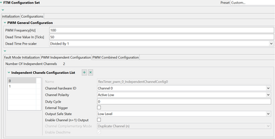

about s32k144 pwm phase shift
6,967 次查看
alice_th
in independent mode , how to set different channel with phase shift, like 10, 20, 30degree phase shift,
i see there is dead time setting, but phase shift setting,
so i enable the deadtime, but no delay between the two channel waveform
could you help to check how to set phase **bleep**ft with tool and attached project, thanks a lot!

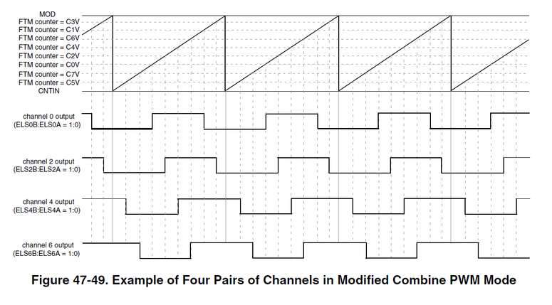

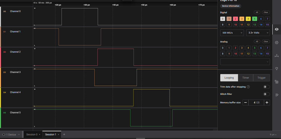

Senlent
Hi@alice_thanks
Please do not create the same question, you must read the datasheet so that you are familiar
with this mode.
For Phase Shift, you need to use Modified Combine PWM Mode, which meets your needs.
I made a three Pairs phase shift demo for your reference
RTM 4.0.1 + Modified Combine PWM + Insert Dead Time + Same Duty Cycle

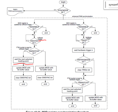

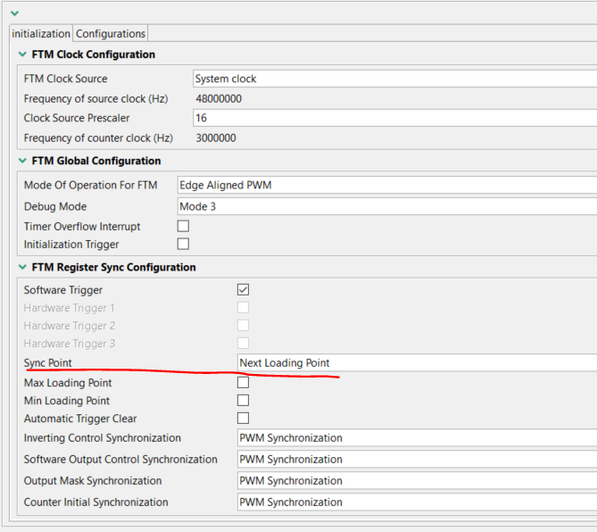

alice_th
hello @Senlent
why 10kHz can use FTM_UPDATE_NOW, 100Hz need FTM_WAIT_LOADING_POINTS ?
i see the chart when software trigger use WAIT_LOADING_POINTS
6,876 次查看
Senlent
Hi@alice_thanks
This is just because the currently executed API (FTM_DRV_UpdatePwmChannel) has not succeeded, and this API is executed again.
You can leave the above configuration unchanged and add a longer extension time to achieve the same effect.

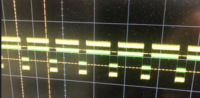

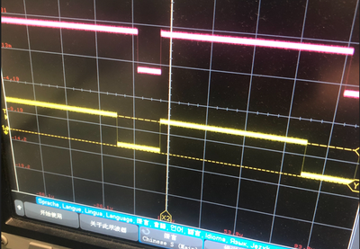

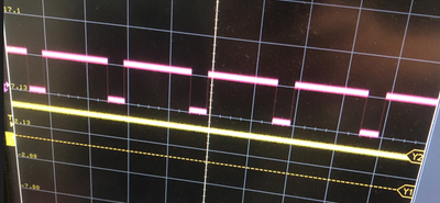

alice_th
hello @Senlent
There should have some problem, ch0-ch1 is dutyCycle = 0x6000,
ch4-ch5 already 0x8000 which means 100% duty cycle, then ch4-ch5 have no pahse shift
same ch0-ch1 is dutyCycle = 0x7000, ch2-ch3 already 0x8000, 100% duty cycle
/* Update PWM channels */
FTM_DRV_UpdatePwmChannel(INST_FLEXTIMER_PWM_1, 1U, FTM_PWM_UPDATE_IN_DUTY_CYCLE, 0, dutyCycle, true);
FTM_DRV_UpdatePwmChannel(INST_FLEXTIMER_PWM_1, 3U, FTM_PWM_UPDATE_IN_DUTY_CYCLE, 0, dutyCycle+0x1000, true);
FTM_DRV_UpdatePwmChannel(INST_FLEXTIMER_PWM_1, 5U, FTM_PWM_UPDATE_IN_DUTY_CYCLE, 0, dutyCycle+0x2000, true);
//delayCycles(0x1FFFU);

alice_th
@Senlent
the output waveform is your demo test result, if you observe longer time, 2 circle time, you will see the problem, i attached the vedio
i just double wether is below cause, maybe seems not .
when the dutyCycle < 0x6000,
all the waveform is correct with phase shift,
but dutyCycle > 0x6000
ch5 secondEdge dutyCycle+0x2000 > 0x8000, that will cause ch4-ch5 will not update
if ((firstEdge <= FTM_MAX_DUTY_CYCLE) && (secondEdge <= FTM_MAX_DUTY_CYCLE))
look at here FTM_MAX_DUTY_CYCLE = 0x8000, that means
 retStatus = STATUS_ERROR;
it will not update the hwSecondEdge
FTM_DRV_SetChnCountVal(ftmBase, (uint8_t)((chnlPairNum * 2U) + 1U), hwSecondEdge);
