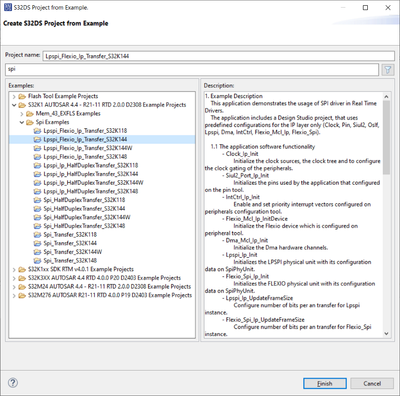

Can you provide a sample source code for SPI communication on the s32k144 microcontroller using library functions?
1 返信
1,122件の閲覧回数
Julián_AragónM
Hi @fengba,
You can import examples from either the RTD or RTM packages for the S32K1xx:
Julián
