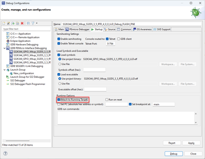

Julián_AragónM
Hi @pulkitp,
When not using the breakpoint, are you attaching to target when running the debugger a second time? Your issue may be that the debugger re-programs the MCU when connecting again.
I am unsure what debugger you are using, but in PEMicro's debug configuration, you can find the Attach to Running Target option inside "Startup":
Julián
