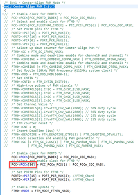

My Edge_Align_PWM_Init function can work based on S32K144EVB, but when I configure CPWM, I select up-down counter,however it can't output CPWM. What is the reason? My Edge_Align_PWM_Init function and Center_Align_PWM_Init function codes are as follows, please help me check out.

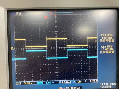

I did't change anything but just copy your demo code to the function void Center_Align_PWM_Init()
1.
2.
the test result is ok in myside.

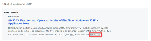

you can refer to this example,i tested this demo code before,
https://www.nxp.com/search?keyword=AN5303&start=0
if you still have problem, please contact me.

Yes,I find and know the 'AN5303' document, in fact I refer to it.
Now the problem is: I configured the code according to the 'AN5303' document,  the actual test results show that the Edge-align PWM (EPWM) example is normal, but the Center-align PWM (CPWM) example is unsuccessful( there is no waveform output in either channel).
I observe that the edge-align PWM mode is selected when QUADEN = 0, DECAPEN = 0, MCOMBINE = 0,COMBINE = 0, CPWMS = 0. and MSnB = 1, and the center-align PWM mode is selected when
QUADEN = 0, DECAPEN = 0, MCOMBINE = 0, COMBINE = 0, and CPWMS = 1. So I write this code "FTM0->SC = FTM_SC_CPWMS_MASK". But no matter how I test, there is no waveform output in either channel.
There is nothing I can do, maybe I missed some details, so you can have a try and tell mw why.

Senlent
Hi@Ryan_Yu
1.
2.
