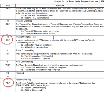

The chip I use is s32k144
I want to ask when SPI sending interrupt is triggered:
In LPSPI_DRV_MasterTransferBlocking function Start SPI data transmission, but the SPI data transmission is completed in the SPI middle service function. I want to know when the SPI transmission interrupt is triggered
Also, what is the condition when SPI receiving interrupt is triggered? Is it when SPI controller puts data into RX FIFO
In addition, does s32k144 have a special chip manual? The chip manual on the official website is a series of chip manuals, and there is no structural block diagram of each module inside the chip, which looks inconvenient

Hi@qiansan
1.you can refer to the following registers,which comes from S32K-RM,
51.3.1.5 Status Register (SR)
2.no separate datasheet for S32K144
BR!

qiansan
The TDF field of SPI status register is read-only and can only mark whether SPI transmission is completed. I would like to ask how to trigger SPI interrupt through software

In this function, only SPI sending and receiving interrupt are enabled, but which statement triggers SPI interrupt
