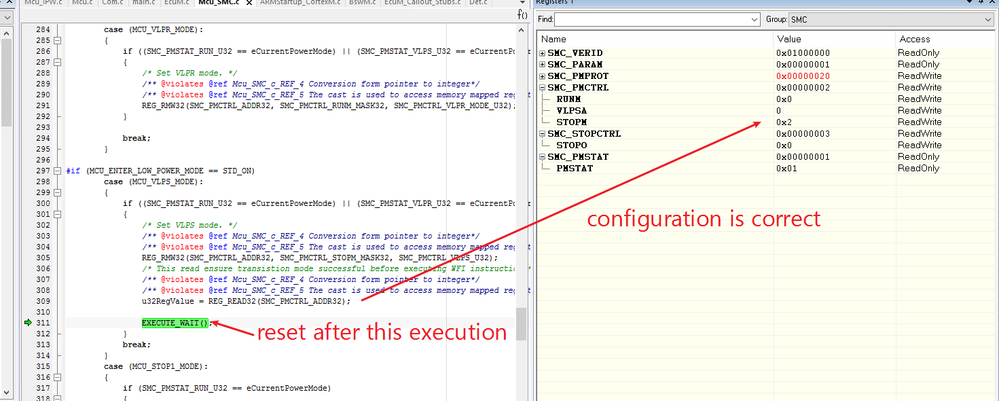

I am facing a tough issue, and have been working on it for a week. But issue not solved yet. so come here for some help.
I am using s32k148, and MCAL (S32K14X_MCAL4_3_RTM_HF2_1_0_1). The issue is when i call function Mcu_SetMode() to enter VLPS, system will reset, with the reset reason SACKERR.
I have call Os_DisableInterruptSource()(Autosar interface) to disable all the interrupt source but except the PTE5 interrupt which is connected to Rx pin of CAN0.
Reset is occured after execute EXCUTE_WAIT.

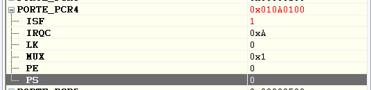

MCU can't be waked up by a external interrupt, which is PORTE, pin 5.
Before enter VLPS, I enable the interrupt.
When in debugger mode, I checked the PCR register, as below, the ISF is set.
My question is, why didn't enter the ISR and wake up the MCU?
Thank you in advance.

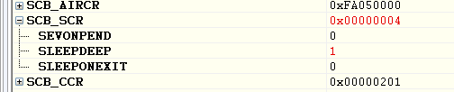

Have you tested the interrupt in the RUN mode?
Does it work?
Do you use Sleep-Now or Sleep-On-Exit mode?
Because in the Sleep-on-exit mode, the MCU goes back to VLPS immediately once the ISR is complete.
So you might not notice the ISR was executed.
BR, Daniel
5,756 Views
huisheng_huang
Yes, it works in RUN mode.
We don't use the sleep on exit mode. as below:
A strange phenomenon is when in debugger mode, after the external interrupt occurs, MCU didn't enter ISR. But if i pause the debug session , MCU enters the ISR.

Can you please disable the FlexCAN module before the transition to VLPS?
FlexCAN is not supported in VLPS and should be disabled.
