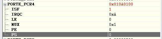

But after that, I have another problem.
MCU can't be waked up by a external interrupt, which is PORTE, pin 5.
Before enter VLPS, I enable the interrupt.
When in debugger mode, I checked the PCR register, as below, the ISF is set.
My question is, why didn't enter the ISR and wake up the MCU?
Thank you in advance.

danielmartynek
Have you tested the interrupt in the RUN mode?
Does it work?
Do you use Sleep-Now or Sleep-On-Exit mode?
Because in the Sleep-on-exit mode, the MCU goes back to VLPS immediately once the ISR is complete.
So you might not notice the ISR was executed.
BR, Daniel

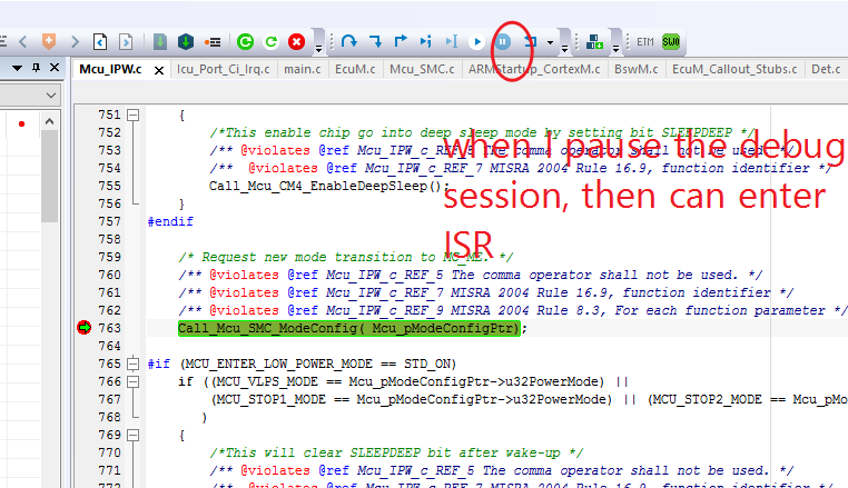

huisheng_huang
Yes, it works in RUN mode.
We don't use the sleep on exit mode. as below:
A strange phenomenon is when in debugger mode, after the external interrupt occurs, MCU didn't enter ISR. But if i pause the debug session , MCU enters the ISR.

danielmartynek
It looks like an issue of the tool not the MCU.
Please try running the MCU stand-alone without the debugger.
I mean, disconnect the debugger, power cycle the MCU and toggle a GPIO (for example) from the ISR.
Also, you can output BUS_CLK on a CLKOUT pin so that you can see when the MCU is VLPS and when it is running.
BR, Daniel
