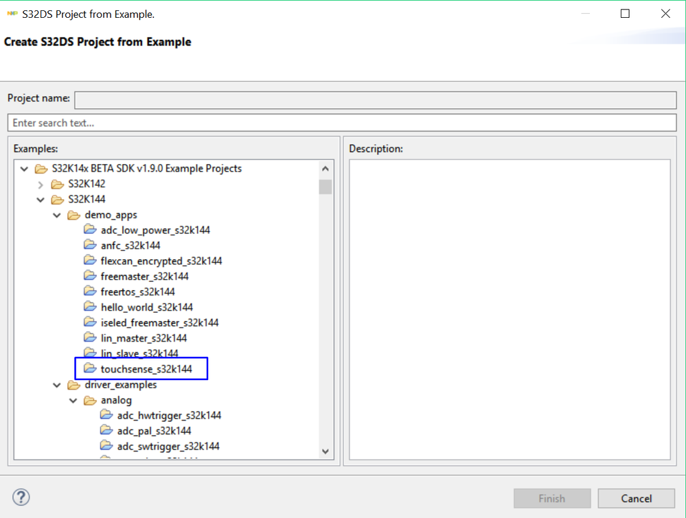

I am not able to find touch electrode example code
1,683 次查看
danielmartynek
Hi Rishi,
Please create a new project from the SDK touch sense example in S32 Design Studio.
