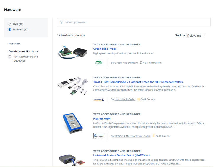

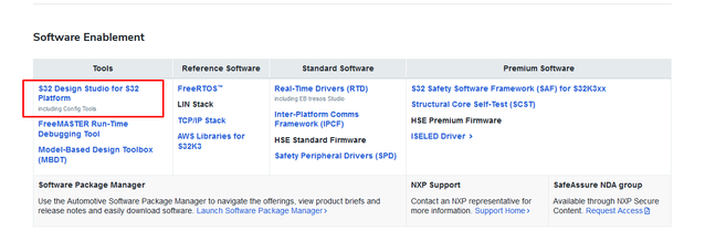

Hi, In the nxp web are there so many information that knowing something as easy as what IDE tools should I install for debugging nxp 32K344 board and debug tools to use seems difficult to find. I would appreciate any information (low cost or free IDEs I mean from NXP and low cost debug tools).

Not sure where the issue is as only IDE we provide is S32DS.
Regarding the debug tools. NXP do not manufacture debuggers. So you can select from wide range of third party debuggers, all of them also come with own IDE, but some like PEmicro or Lauterbach can also be used with S32DS.
