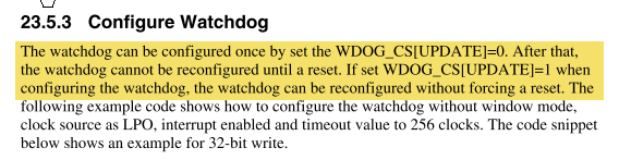

Hi all
      Can i configurate wdog when WDOG_CS[UPDATE] is 0 without reset
1,661 Views
lukaszadrapa

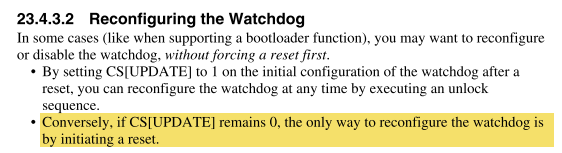

I think the reference manual is quite clear in this case:
So, the answer is no.
Lukas
