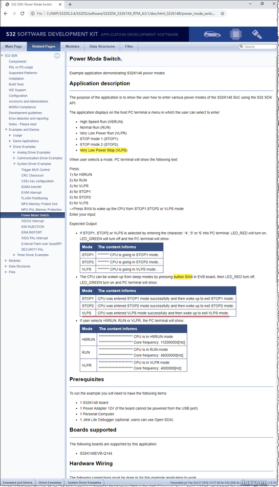

You can refer the power_mode_switch_s32k148 example in S32SDK S32K1XX RTM 4.0.1.
Asynchronous Wake-up Interrupt Controller (AWIC) detect asynchronous wake-up events in stop modes and signal to clock control logic to resume system clocking.
Pin interrupts one of the VLPS wake-up sources.
There is not much information about the AWIC module in our manual. But it mentioned: Full documentation for this module is provided by Arm and can be found at arm.com.
So I think consulting ARM may get more accurate answers.

Yes.
