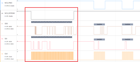

Hi all,
I have some issues about using the SPI module.
I want to use the S32k148 SPI0 to control two slave PMIC(FS65) and EEPROM(M95M01)
Because of the different baudrate and framsize, need to re-initialize the SPI0 configurations in the runtime. Before SPI data transmited, deinit the SPI first and then re-init SPI with the corresponded configuration.
status_t StartBlockingTransfer_SPI0(lpspi_which_pcs_t cs, uint8_t* u8_tx_buff, uint8_t* u8_rx_buff, uint16_t u16_len, uint32_t u32_timeout)

Now I want to change the different configurations after the EEPROM page-write(256 bytes) transmitted completely, how could I make it?
About 16 bytes transmitted and then  SPI0 deinit.

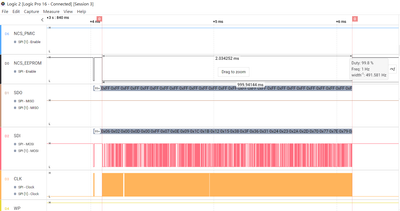

What's the value of u16_len and u32_timeout? If time expires SPI_MasterTransferBlocking()  will return error and the transmission will be aborted. Did you check the return value?

I set the value u16_len = 260U,and u32_twmeout = 10U.
For testing, I close PMIC SPI and only EEPROM SPI active.
Also, I trace that the SPI messages fully transmitted is taken about 2ms.
