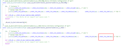

As shown in the screenshot, set NO.0  and NO.1 Devices SpiCsBehavior 1.
But code shows only Device1 has changed.why?
My RTD  is SW32K3_RTD_R21-11_3.0.0_P07

Hi @RyzeBai,
I'm not able to reproduce it using the Spi_Transfer_S32K344 (RTD_R21-11_3.0.0_P07) example in Tresos 29.
Can you share the whole project, or a test project that can replicate the issue?
