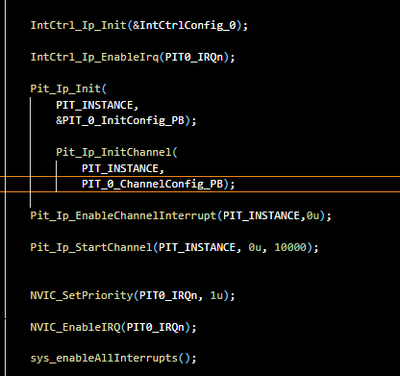

Hi, I have been trying to use PIT timer, however I am unable to generate interrupt using PIT timer on S32K310.
I am seeing the down counting in debugger but not interrupts.
Never hits the interrupt breakpoint.

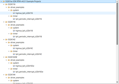

Krishank
Hi, I do not see those examples on my IDE
All I see is this
Also I believe the RTD version I am using is 4.0.0
1,878 Views
Senlent
Hi@Krishank
The image is not RTD 4.0.0.
The image you show is not RTD 4.0.0 for S32K3, but RTM 4.0.1 for S32K1.

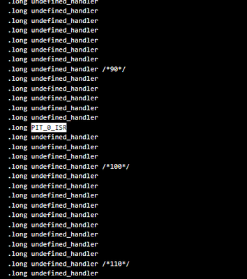

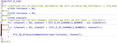

Krishank
This is also defined here in Vector.S
