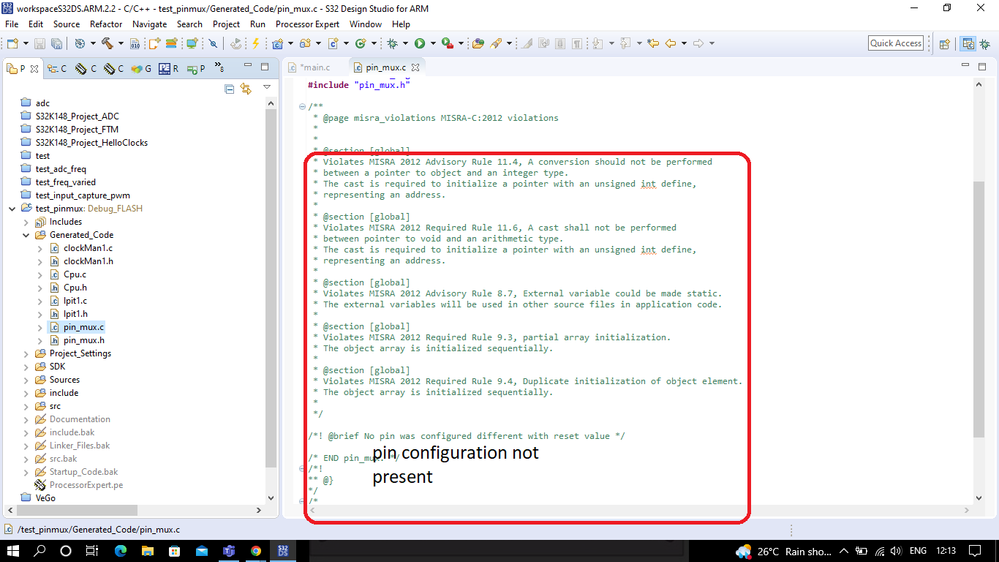

got some issue while generating processor expert code for pin configuration for  ADC0 in pin mux
step i have used is :
1->opened pin mux ->selected Channel 0 PTA0 as input.
2-> cliicked on project tab --> clicked on generate processor expert code
issue -> generated code not present in pinmux.c file.

dhirajtarole
but if we select multiple pin also ,the code will not generate in pin_mux.c file.
lets assume i have selected multiple pin like
ADC0-> PTA1/PTA6/PTA7/PTB0/PTB1/PTB2/PTB3... INPUT and click on generates processor expert code
code will not generated in pin_mux.c file as well.
see generated code below:
/* MODULE pin_mux. */
#include "device_registers.h"
#include "pin_mux.h"
* @page misra_violations MISRA-C:2012 violations
* @section [global]
* Violates MISRA 2012 Advisory Rule 11.4, A conversion should not be performed
* between a pointer to object and an integer type.
* The cast is required to initialize a pointer with an unsigned int define,
* representing an address.
* @section [global]
* Violates MISRA 2012 Required Rule 11.6, A cast shall not be performed
* between pointer to void and an arithmetic type.
* @section [global]
* Violates MISRA 2012 Advisory Rule 8.7, External variable could be made static.
* The external variables will be used in other source files in application code.
* @section [global]
* Violates MISRA 2012 Required Rule 9.3, partial array initialization.
* The object array is initialized sequentially.
* @section [global]
* Violates MISRA 2012 Required Rule 9.4, Duplicate initialization of object element.
/*! @brief No pin was configured different with reset value */
/* END pin_mux. */
** This file was created by Processor Expert 10.1 [05.21]
** for the Freescale S32K series of microcontrollers.

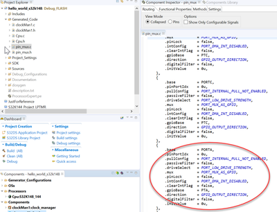

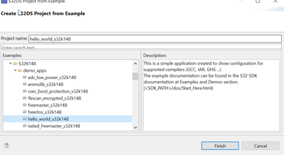

we can do a test to troubleshoot the problem,
1. import the sample project in the SDK,for example.
a.import the demo: hello_world_s32k148
b.made some changes,for example,we set the PTA0 to GPIO output,then generate the code.
2. Check whether the updated results have changed
4,958 Views
dhirajtarole
Spoiler
hi,
For GPIO it is working, we will get a code as shown in your pin_mux.c file.
can we get same code for ADC0 in pin_mux.c ?
lets assume, we need to perform ADC operation for that we are generating ADC0 code and calling ADC0 function in the main.c file.
1.will this ADC code will run without pin_mux configuration ?
2.or for ADC , in pinmux Direction are given default(INPUT). just we need to select on which pin we want for ADC Channel (using pin/Signal Selection) ? --(AT this condition it is not generating code)
thanks,
