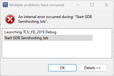

Hi All,
while debugging the workspace using PE micro, we are getting following error.
please help us to resolve this issue.
Microcontroller: S32K144F512M15
IDE: S32DS v2.2
Debugger: PE Micro Multilink Universal Debugger

Daniel-Aguirre
Are you using any provided examples?
It seems that you may be experiencing a problem with your debugger. The following link should provide more insight on a similar issue that may provide useful:
https://www.pemicro.com/forums/forum_topic.cfm?forum_id=9&forum_topic_id=6331
Please, let us know.

Rajpuj
Hi Daniel,
Thanks for the quick reply. I have followed the steps given in the link but couldn't resolve the issue. can you please help us to resolve the issue.

Daniel-Aguirre
Thanks for your feedback.
There is also another community thread talking about this same topic:
Internal error during Start GDB Semihosting Job on... - NXP Community
The solution being talked in it is to uninstall the latest PE Micro update.
