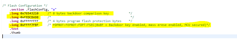

I'm working with S32K116 microcontrollers, trying to set the MCU in secure mode and later switch it to unsecure mode using the backdoor key, as described in the S32K Reference Manual in section 36.5.12.2.1. To do this, I have a code where the first step is modifying the startup_S32K116.S file by adding the backdoor key in the flash configuration section and setting the FSEC to 0xF instead of 0xE at the end, to put the MCU in secure mode. Here's an example in the following image:

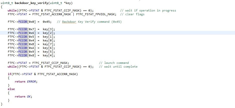

Then, I create a function to update the FCCOB register, as described in the manual, to check if the key is correct and switch the MCU back to unsecure mode:

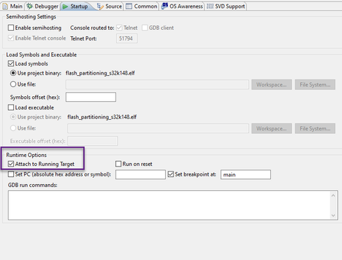

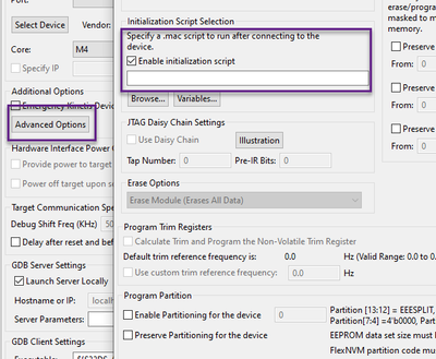

The PE Micro plugin in S32DS IDE allows the Multilink to be attached to the MCU without reset:
Once attached, you can halt the core and debug the MCU.
To erase the MCU after that, you would need a script, I guess.
Please contact PE Micro support.
