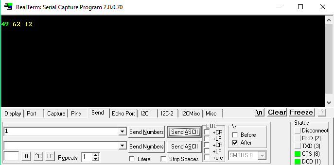

Hi to the community,
I am trying to send an uint8_t number using this function:
void LPUART1_transmit_int(uint8_t number){
while((LPUART1->STAT & LPUART_STAT_TDRE_MASK)>>LPUART_STAT_TDRE_SHIFT==0);
/* Wait for transmit buffer to be empty */
LPUART1->DATA=number; /* Send data */
But it doesn't work. I am going to attach the code below.

danielmartynek
If the program receives ‘1‘ in ascii which is 49, it will return ‘>‘ (62) and uint8_t = 12.
It seems it works.

electronica2pow
  I was using Putty and it doesn't simulate it correctly, so i know that i wasn't using the right program, as always, Thanks Daniel!
