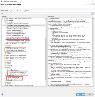

I have been looking at the UART simulation LIN of S32K recently, can you provide some help?
3,463 Views
PetrS
can you specify the device you have?
Anyway the S32Design Studio includes several demo examples showing LIN communication using LPUART module, using SDK/RTD drivers or baremetal one.
BR, Petr

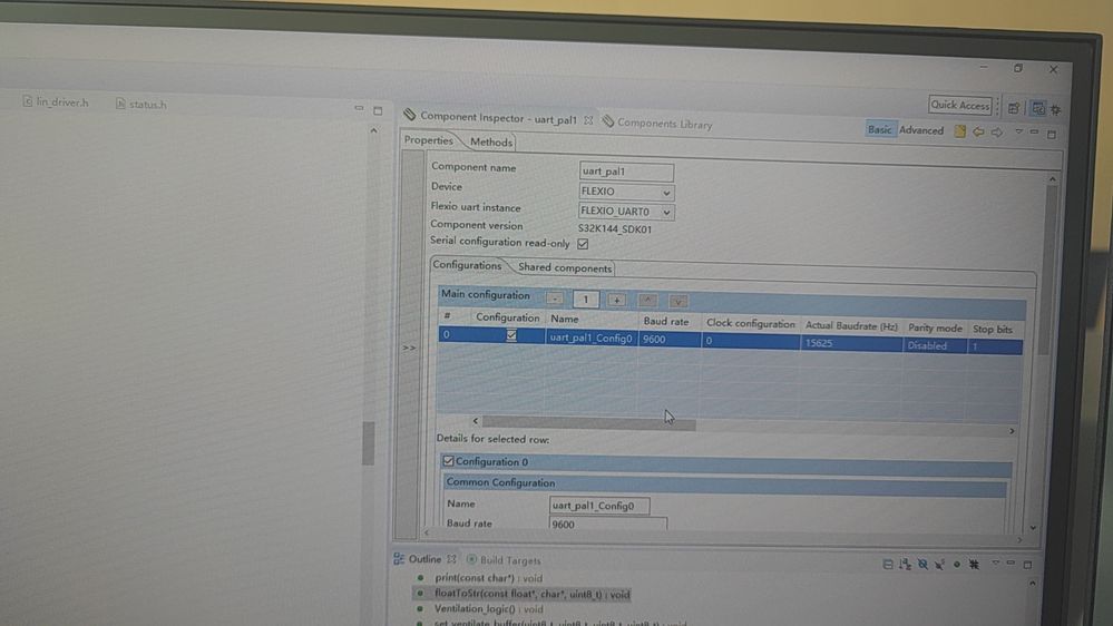

hds
HI
I have configured FLEXIO's uart, but I cannot select my configured URAT in the LIN component118108696a1bcc1712e321d34f7c54e.jpg118108696a1bcc1712e321d34f7c54e.jpg

Hello, you can also provide some examples of ordinary serial port to simulate LIN communication
3,441 Views
PetrS
baremetal code for LPUART LIN can be found e.g. in https://community.nxp.com/t5/S32K/S32K144-LIN-bus/m-p/818963
the SDK or RTD offers below examples for LIN, taken from S32DS3.4
BR, Petr

Hello, the device I am using is S32K144 and I want to use FLEXIO's uart to simulate LIN communication, do you have any suggestions? I have not seen relevant examples at present
