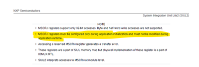

I tried to change pin configuration during runtime, it seems not possible.
And NXP document also mentioned it.
what could be the solution?   a MCU reset is needed to load different pin mux config data?

PetrS
Hi Kevin,
yes, the pin pin level is retained during the Standby. If you need low level you will need to change to GPIO here.
For the MSCR reconfig, this can be done as per user needs. The Apps feedback for this is..."the user can modify the MSCR during the runtime, just taking care of the correct initialization | configuration. The note in the RM is that we cannot recommend doing that because it is not the ideal application, but not for the internal capabilities."
BR, Petr
