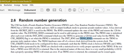

In Reference Manual is written that there is TRNG:
So there is TRNG, but it cant be used? So what for is intended TRNG_RND command (but I could not find it in the CSEC API)

lukaszadrapa
As I said, user can't get the true random number.
The TRNG is used only internally to generate seed for PRNG. This implementation is required by SHE specification.
Lukas
8,078 Views
Vojtech
OK, got it, so only pseudo random number is possible.
