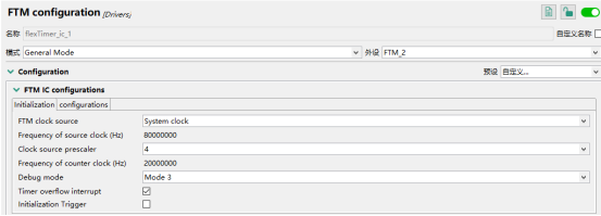

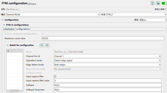

Application background: Configure FTM2 as capture mode to capture three-phase Hall signals for BLDC motor control.
Problem description: Adding an instruction to reverse GPIO at the input of the FTM2_Ch0uCh1_IRQHandler() interrupt function, it was found that the capture trigger time can be delayed by up to 3.2us compared to the captured signal. As shown in the following figure:
CH1 channel (yellow waveform): FTM2 captures interrupt reversal IO port;
CH2 channel (blue waveform): periodic square wave generated by the signal generator;
My FTM2 configuration is as follows:
Configure reference information, refer to this image:
Specific configuration information of FTM2:

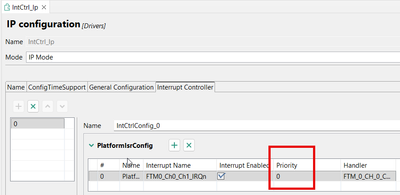

Thank you for your interest in our products and for contributing to our community.
Maybe the CPU is attending another interrupt, set priority according to your needs:
We hope this resolves your issue.

Hi @_Leo_
I am glad to receive your reply.
I only set the interrupt priority of "FTM2_Ch0_Ch1_IRQHandler" to the highest priority 0, and tested again, the fault still persists. As shown in the following figure:The maximum delay time reaches 3.115us
According to my configuration, can you retest it on your end to see if it is normal?
