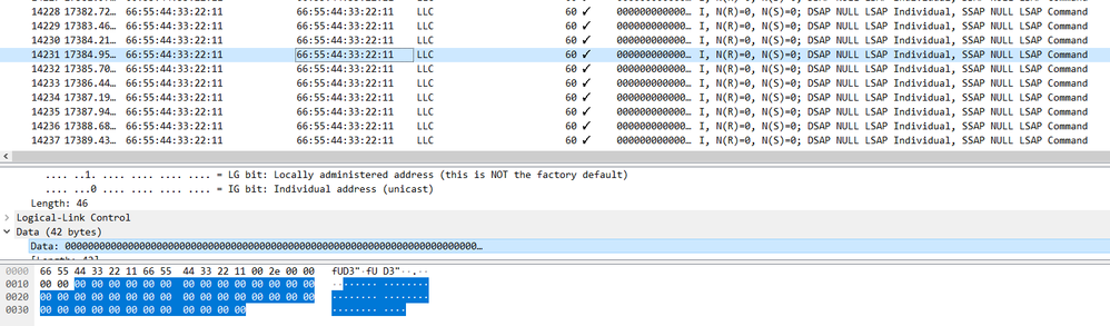

I used Wireshark to capture packets, but couldn't get any information.My clock and pin configuration are correct. I created a new demo "Gmac_Ip_InternalLoopback_T172_S32K344" and got that,I used the Eth_43 interface to test the loopback. The program indicated that the test was successful, but Wireshark couldn't capture any data.How can I capture the message information of gPTP? or any information with Eth_43 API?gmac_ip_looback_wireshark_cap.png

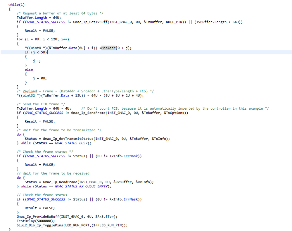

This is the code for gmac_ip.

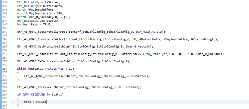

This is the code for Eth_43.

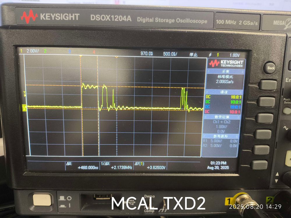

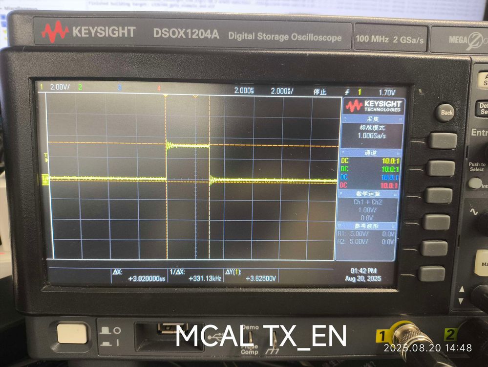

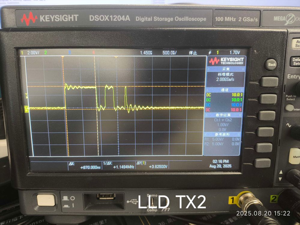

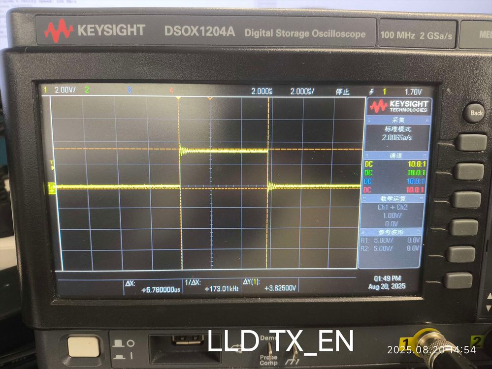

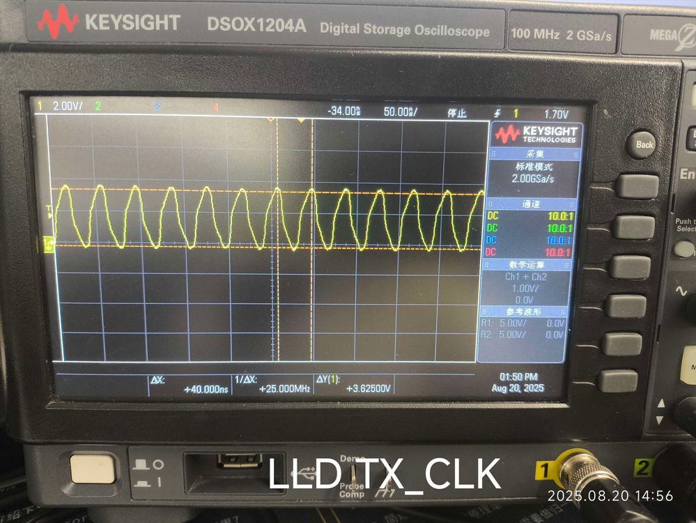

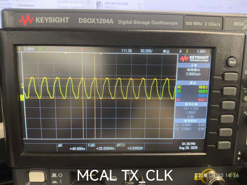

I sent the same message to both MCAL and LLD, but when capturing the waveforms with an oscilloscope, I found that the tx_clk of MCAL was 25M, while the waveforms on tx_d2 and other data lines were significantly faster than those of LLD by a factor of two. Why is this happening?1.jpg2.jpg3.jpg4.jpg5.jpg6.jpg

3,691件の閲覧回数
FrankLiu2019
Hi Pavel
Thank you for your reply. There is no particular reason to use the MII interface, because the hardware is designed this way.

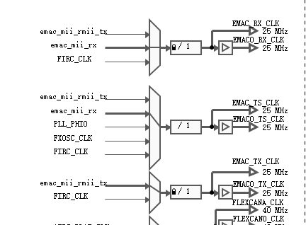

I configured PTD10 as CLKOUT_RUN and used it to test whether the configured clock was correct. The results show that emac_mii_rmii_tx and emac_mii_rx are both correct at 25 MHz.
I traced the Eth_43_GMAC_Transmit function all the way to Gmac_Ip_SendFrame, and found that the TxFrameBuffer data was consistent with that at the LLD stage.
However, as I mentioned earlier, the clocks for TX_EN and TX_DATA in MCAL are faster.
I'm not familiar with MCAL. Could you explain the reason?

I believe that the  frames should  not be sent to the PHY at loopback mode. However, the opposite is true. In the LLD API, the  frames can be captured by Wireshark both the loopback mode and the non-loopback mode . In the MCAL API, the frame can be read through Eth_43_GMAC_Receive  at the loopback mode (the waveform captured by the oscilloscope is different from that in the LLD), while Wireshark cannot capture any data both the loopback mode and the non-loopback mode.

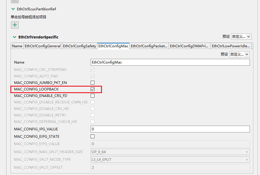

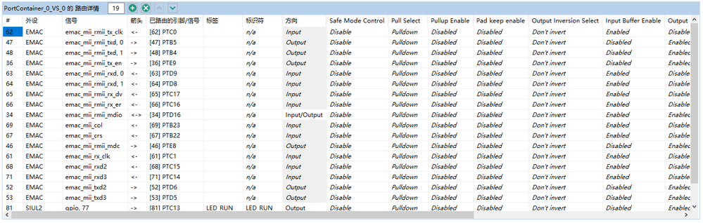

Some additional informationclock2.pngenable_loopback.pngenable_mii.pngpins_config.pngclock1.png
