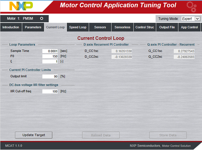

Can you make a screenshot of the current control loop settings for me?

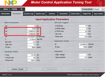

Are motor parameters measured properly? specifically stator resistance Rs and d-axis and q-axis inductance Ld, Lq ?

1) Speed FOC & Sensorless Type.
2) current control loop settings
-> I checked that the Fo value was set to 300hz and changed it to 150hz. As a result, the existing noise has been removed. The problem seems to have been resolved. thank you.
Please inquire about the applicable bandwidth frequency setting.
