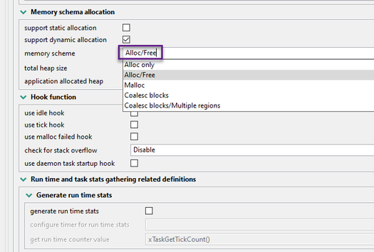

I am using NXPS32k344 Board in my project. In my project  i am using free rtos to run my program. In my program i am running three different tasks with different priorities, while i am trying to delete one of my Task using  vTaskDelete(NULL) function my program is stucked  at  configASSERT( pv == NULL ); in heap_1.c file.

The answer is in the screenshot you posted (heap_1.c)
/* Memory cannot be freed using this scheme. See heap_2.c, heap_3.c and
* heap_4.c for alternative implementations, and the memory management pages of
* https://www.FreeRTOS.org for more information. */
Use heap_2, for example.
