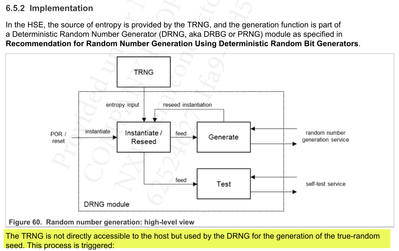

TRNG is not accessible for user:

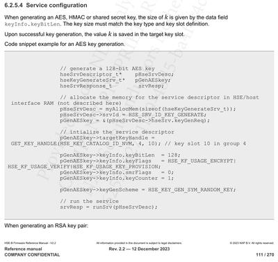

 Here's an example how to generate symmetric key:
