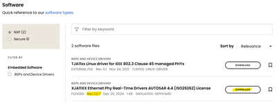

I am trying to work with the TJA1104 PHY with MACsec. I understand that there is a driver (RTD) from NXP for the TJA110x family.
What i dont understand is, if there is MACsec supported by these drivers or not. I couldnt find anything about MACsec in the source code or example projects.
All i can find are the lwip, eth & PHY examples, which use the basic TJA110x phy driver.
(I am working with an S32K148 evaluation kit)
Many thanks for any hints or help!
905 Views
PavelL
Hello @eugstluk ,
MACsec is supported by PHY's RTD since 1.0.2. You should use the latest one, 1.0.7.
