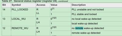

Hi NXP experts,
we want to know if remote wake up status register will be latched when this situation occurs and tja1101 perform a reset function.
1,161 Views
PavelL
Hello @zhaoning ,
the flag shall be cleared after reset. Remote_WU is only set when the PHY receives a WUP over the LINK.
