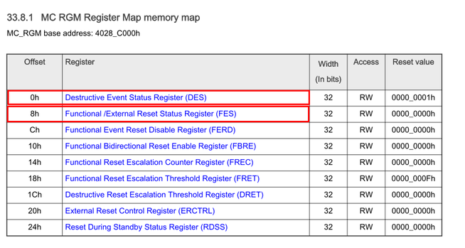

Issue: When I attempt to change the clock configuration to normal after waking up, the system resets. Please provide guidance or suggestions on what might be causing this issue.
Which kind of reset do you see after reset in the RGM (FES/DES) module?

Hi @petervlna ,
   I seen DES type reset in RGM and getting Power on reset.
Make sure you clear the reset flags after power on reset in your SW.
This way you will remove all the possible remnant latched resets in DES/FES.
So you see DES flags set? Which ones?
POR flag can be remnant of the board power up phase from before wakeup.
