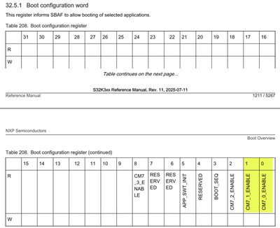

I can see in your code that core 1 is enabled right in the boot configuration word, so it's started immediately after reset:

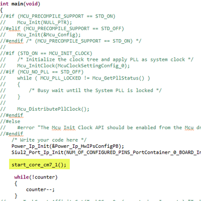

However, you are trying to enable core 1 in main function of core 0 again with some delay loop after that:
Isn't this the root cause of your troubles?

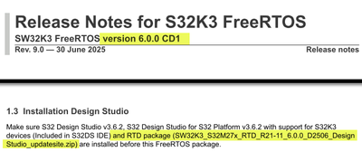

It's highly recommended to use RTD version which is mentioned in the release notes file:
Lukas

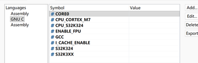

I disabled the D_CACHE_ENABLE,but the program is still stuck there.
Zyp_1-1758790020092.pngZyp_1-1758790020092.pngZyp_2-1758790049111.pngZyp_2-1758790049111.png
You can tell me what additional information is needed to solve this problem?
