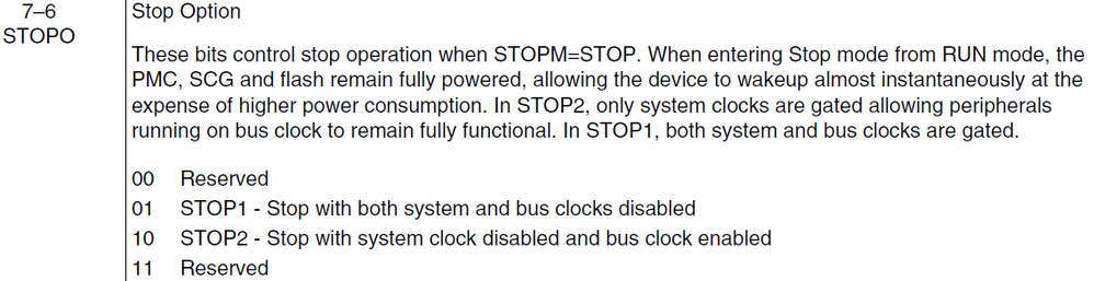

In my datasheet (revA), I can configure the normal stop mode and it works:
So I don't know if it is an error in the datasheet.

Thank you for your help. I have one additional question: what happen if PSTOPO is set to 0 ? (normal Stop mode). Because in this mode, the consumption is very low and I still can wake up from sleep using an internal timer or by port interrupt. When I use STOP1 or STOP2 mode, the consumption is too high.  How can I reduce the consumption if I use STOP1 or STOP2 ?
11,732 Views
danielmartynek
According to the datasheet, if Normal Stop Mode is set (PMCTRL[STOPM = 0b000]), the STOPO bits in the STOPCTRL register must be used to select the variants of stop - STOP1/STOP2. STOPO(0b00) is reserved.
The consumption varies depending on peripherals you use. See chapter 33.8 Module operation in available low power modes in the datasheet. And compare VLPS and STOP mode.
