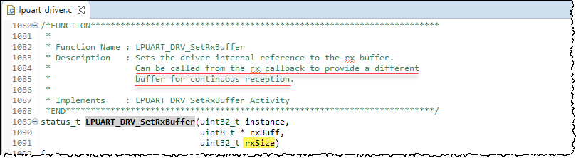

LPUART_DRV_ReceiveData(INST_LPUART0, &rbuf, 1); here you set the rxSize=1, so it will only receive one date.
Interrupt-based communication nobookmark .pngInterrupt-based communication nobookmark .pngLPUART_DRV_ReceiveData main lpuart_driver.pngLPUART_DRV_ReceiveData main lpuart_driver.png
LPUART_DRV_SetRxBuffer can be called from the rx callback to provide a different buffer for continuous reception.
