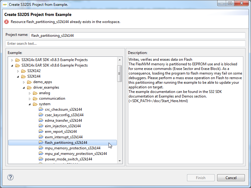

I'm searching any sample code of Read & Write FlashROM of S32K.
If anyone know, I'm very glad if you tell me.

you can look at example flash_partitioning_s32k144. It is part of S32DS Installation. (File -> New ->S32DS Project from Example)
Jiri

Thanks so much!! You saved me! Thanks again:D
