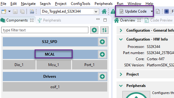

Hello, everyone.
    I just downloaded s32ds software, clicked the example and compiled it. There was an error in the picture, 'fatal error: MCU h: No such file or directory '    why?    I just downloaded the software. I hope you can give some suggestions.
3,347 Views
danielmartynek
Hi @dashe,
You have to generate the RTD code first.
Double-click on the .mex file.

Thank you very much.
